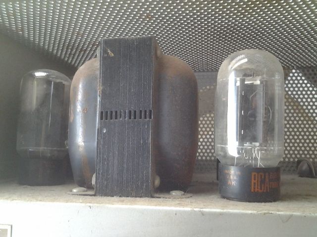

Any feedback on my latest purchase?
Hammond big iron on sale.   :icon_biggrin:
Here's what I make of this item.
1 beefy PT.
2 PP 20+W OTs for EL84 or 6V6 amps.
1 PP 30+W OT for 6L6 or some kind of Bass amp OT?   :dontknow:
The questionable OT is being driven by 2 7591s at +400V to an 8 ohm speaker.
It is labeled Bass amp and has 130 ohm coils on each side of the CT.
7591 data sheet shows 6.6K plate load at 400V for 32W output.
Any idea if this is OK for 2 6L6s?
If not, any suggestions for what it might be used with it besides the 7591s?
I saw 6GM5s listed as a 9 pin equivalent of the 7591.  I don't think I have any of those either.
I'll have to double check my tube inventory.  LOL
PS.
I think the seller has 1 more of these available at the BIN price of $29.95   :think1:
With my sale he sold 3 of these in the last 24 hours.  They are going fast.   :icon_biggrin:
« Last Edit: January 13, 2016, 09:31:02 pm by Paul1453 »
1 beefy PT.
Stereo.
The EL84 OT's are for left & right of the stereo spectrum. I've not had one of these amps but I'll venture a guess these OT's are small for their power through-put. That's because there's no low end for either the left or right channel being passed through them... That's been shaved off by the 3 C-R (high-pass) filters between the input jack and the 7199 pentode driver of the output stage.
The bass for both left & right channels is passed through 3 R-C (low-pass) filters between the input jacks and the 7591 channel's pentode driver. The bass-only sound is amplified and applied to a much bigger OT for connection to the woofer. This works because bass is generally omnidirectional, which is why stereo mixes evolved to sitting the bass right in the middle of the stereo picture... If you have any deep lows, it doesn't convincingly sound like it's coming from only the left or right speaker (and also why you have a single subwoofer speaker in a modern stereo setup).
It would seem a shame just to rip it apart. You never wanted to hear your tunes through a tube stereo? All you need are the speakers, tubes and a check that electrolytic caps are still good... Then verify you have or can make all needed power supply voltages.
7591 is a 19w 6L6 in a 6V6-sized bottle, with a much-twitchy-er gas pedal. Has ~70-80% higher Gm, so it take less drive signal and bias to make its output power as compared to the 19w 6L6.
7591's used to be $75-80 a bottle; now there's new production as cheap as ~$18/bottle. Or you could ebay them & find some on occasion for less. Switching to 6L6 means bias supply re-design and possibly an added gain stage or changed/redesigned inverter to give them sufficient drive to produce low end to match the EL84 channels. Buying some 7591's is the shorter path to joy.

My first inclination when looking at this was to keep it all together as a stereo amp, but then I considered not having all the necessary tubes and a speaker cab with the 3 speakers, so I then evaluated just the transformers instead.  I concluded that the transformers alone were worth considerably more than I had to pay, so I pulled the trigger.    :l2:
I have a need for at least two EL84 PP OTs for my current stock of premium tubes.
I don't want to kill any more little unknown wattage OTs, and only have 1 PP OT I'd like to reserve for my breadboard set up.
I don't think that OT could handle 2 6L6s, so the Bass amp OT seemed like it might be a bonus item.
I have at least two extra PTs in stock that would easily work with the EL84s.
I hoped I could use this beefy PT and unknown OT to make a PP 6L6 amp.
I did read something about this particular Hammond model having some failure issues.
Is this really a shame to part this out to make 3 amps instead of 1?   :w2:

Re: favorite old gear to buy for parts
« Reply #212 on: January 14, 2016, 09:42:05 am »
There is no PT on the AO-70 chassis.
« Reply #213 on: January 14, 2016, 10:02:10 am »
Just so you know: I think Hammond Organs and Hammond Transformers are totally different companies.
Yes, I think you are correct about that and everything else you post about tube gear!   :worthy1:
Hammond Organs did use quality transformers that were designed and matched well with their output tube circuits, correct?
With so many people converting Hammond Organs into guitar amps, I'm guessing these transformers work well for that?
Usually you will find Inductor (Choke) inputs on organs and organ cabs.  This will give you a voltage multiplier of .08 to 9.  Also it makes for much smoother DC and will make for a very different Guitar amp.  If you are looking to build a very clean Guitar amp this is a good way to go.
I have one which I used 12Ax7 to a 12aU7 PI and 4, 6v6 tubes from a JR20 Tone cab.  Hooked up to a Hepner 12 AlNico sounds very much like a Standel.
Offline Paul1453
  • Posts: 1085
« Reply #214 on: January 14, 2016, 10:09:43 am »
Really?  I see four transformers.
Three OTs and a Choke then?
Then the big black one is for the 7591s?
I think you are correct in that PS components are labeled 7xx and power amp 3xx.
I'm having a hard time locating that (choke) on the power amp schematic.
It's all good.  I happen to have an excess of PTs at this time.
So I have a PT for each proposed amp already in stock. :icon_biggrin:
« Last Edit: January 14, 2016, 10:33:43 am by Paul1453 »
Offline Paul1453
  • Posts: 1085
« Reply #215 on: January 14, 2016, 12:03:05 pm »
You are correct, Sir.   :worthy1:
This shows a more complete setup, and that really is a beefy PT.   :laugh:
