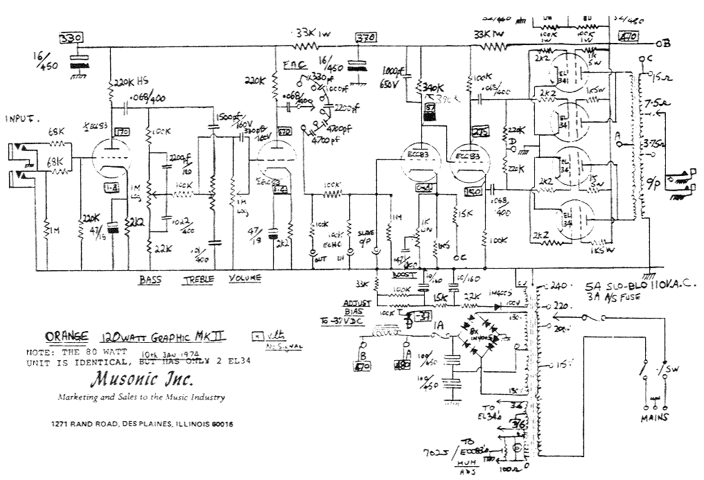

Offline chocopower
  • Posts: 581
Re: gain - bypass ?
« Reply #12 on: April 04, 2016, 04:32:24 pm »
Orange uses a similar concept, but with a pot.
They use a smaller cap so is more a presente control, but the idea is the same.
http://www.drtube.com/schematics/orange/grmk2mus.gif
David
