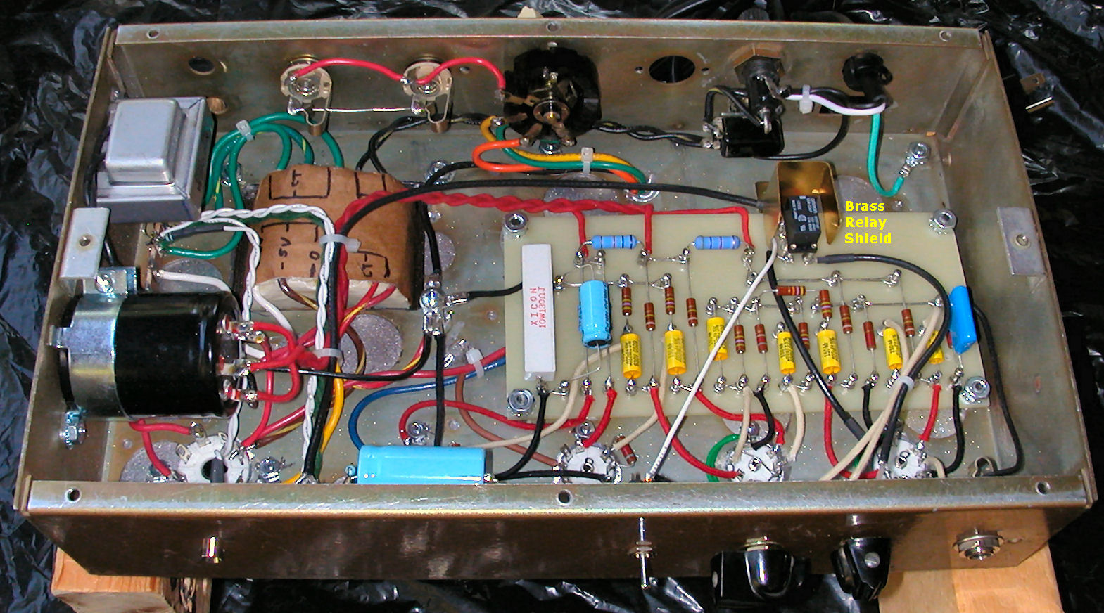

Thanks all for the help. The bright pot and the master vol both have a buzz. I'm wondering if those resistors R10 and R11 and C5 need to be grounded? The pot is grounded but I don't have the R and C wired to the back of the pot...just to each other.. Hard to tell from the schematic. Thanks
https://el34world.com/Hoffman/files/Hoffman_Plexi_6V6-V2.pdf
I have good readings at A and B, (about what it says on the schematic)..then nothing (as in no current)  :BangHead:at C or D or E
Lights come one - tubes heat up and nothing... not even a buzz.
I used a MM OT - 18W - brown/red with a white center tap....
Here are some pics.

Did you check  r39 ?  If well soldered and value is aprox 20k you should have voltage in C

Hi Thanks all - I did those things from the "do this first" list.
The problem turned out to be a dead cap - that Ajax .022. It literally came apart when I touched it and that was that.
I swapped it out and I'm getting good sound. The bright vol and the master vol have a buzz - I need to run that down...

is the secondary of the OT wired correctly to the impedance selector switch? i see the orange wire tied to ground on the output jacks and the black wire tied to a switch pole. is the black wire the common? i believe that it is, however cannot confirm since the supplier of your OT is unknown. if you have the hoffman or classictone part, then swap the orange wire and the black wire.
orange is 16Ω tap
green is 8Ω tap
yellow is 4Ω tap
black is common/ground
deduced from the last picture of your opening post.
https://el34world.com/projects/images/DSCN1697.JPG
Offline newguitarsmell
  • Posts: 169
Re: more problems with plexi build
« Reply #12 on: June 02, 2019, 12:51:17 pm »
Pete - -
OT is Mercury MAR18-OT
PRI                       SEC
Red                       ORANGE - COM
White                    BL - 4 Ohm
Brown                   YEL - 8 Ohm
                            GR - 16 Ohm
That's why the Orange wire is where it is.....??

Your impedance selector and speaker jack are wired wrong. You have a green wire connected to the common lug of the switch. That common lug should connect to the tip of the speaker jack. Then the Black, yellow, and green OT wires should connect to the other three lugs on the switch.
The orange (common OT wire is properly connected to the ground lug on the speaker jack. But there is a second orange wire connected to the jack also. Where does this wire go? If it is supposed to be the NFB wire then it should not be connected to the speaker jack ground lug.
The yellow wire between the switch and the speaker jack is connected wrong on both ends. Just remove it and throw it away.
Now connect the common lug of the switch (mentioned above) to the tip of the speaker jack. The tip of the speaker jack is the lug that you have never soldered to.
I don't see a NFB wire unless the second orange wire I mentioned above is it.
I just completed a project using that exact same switch. My OT wires are white, yellow, and green. I used a gray wire between the switch common and the tip of the speaker jack. Here's a pic that may help you get yours wired correctly...
     http://sluckeyamps.com/phoenix/p12_big.jpg
When you get your impedance switch, speaker jack, and NFB wire connected properly, your hum issues may disappear as well.

put it aside, and build another
:laugh:
after 18 of 'em I gave up and figured out how the wise here did "IT" and copied  :icon_biggrin:
study an Sluckey gut shot, a lot, then more, then sloooow down to a snails pace, walla, power up n jam

  • Posts: 11604
« Reply #37 on: July 02, 2019, 07:12:10 pm »
 :l2:
I'm the poster child for ADD, so I understand
I my profession I lernt the turtle ALWAYS wins, make a mistake, bad things happen to good ppl!
here's a before n after, us slow learners can learn  :laugh:
