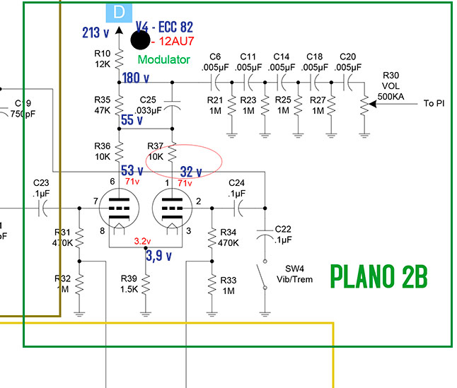

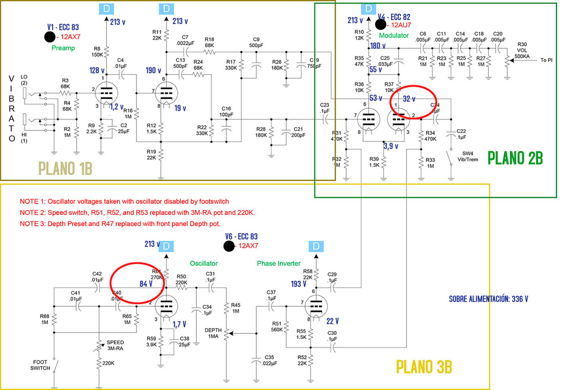

Something seems fishy, I suggest to verify the values of R35,36,37.
Offline rafaelctt
  • Posts: 199
Re: Vox Ac 15 vibrato problem
« Reply #7 on: June 05, 2022, 05:00:48 am »
I just measured the values ​​of the three resistors R35,R36 and R37 and they are correct.
With SW4 open, the voltage on pin 1 of V4 goes up about 8 V and it sounds louder.
« Last Edit: June 05, 2022, 05:15:21 am by rafaelctt »
Offline trobbins
  • Posts: 307
    • Tim's projects and info
« Reply #8 on: June 05, 2022, 05:33:42 am »
Have you swapped tubes?  Apart from the obvious anode voltage difference on V4, have you confirmed appropriate LFO AC voltage (measured from a scope, as a meter is unlikely to give an accurate rms voltage) on top of R45, and also top of R32 and R33?

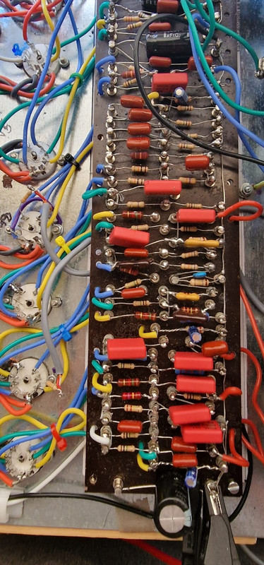

Let's see a hi-rez pic that shows V1 and V4 and the section of the board that contains the modulator components. Pic needs to clearly show components so we can read values. We also need to see all the components between V1 and V4.

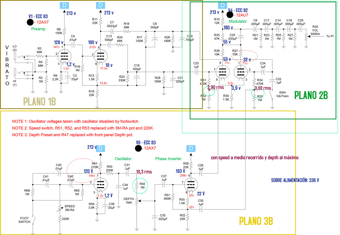

At this moment I don't have another Ecc82, only Ecc83 from other parts of the circuit.
The oscilloscope voltages that I obtain are: 2.90 rms in R32, 3.02 rms in R33 and 10.3 rms in R45. These measurements are with SPEED at halfway and DEPTH at maximum
<a href='https://postimg.cc/tYHtPK91' target='_blank'><img src='https://i.postimg.cc/VLJGywTF/medidas-tensiones-vibrato-para-foro-2.jpg' border='0' alt='medidas-tensiones-vibrato-para-foro-2'/>[/url]
  • Posts: 5401
« Reply #12 on: June 05, 2022, 06:57:21 am »
This means post a PHOTOGRAPH of the inside of your chassis, not the schematic.

« Reply #13 on: June 05, 2022, 07:43:59 am »
« Reply #14 on: June 05, 2022, 01:19:22 pm »
If it is not the plates, and common cathode, then look at the grids.
Resistance from pins 2 and 7 to ground? Examine all solder joints closely.
Offline rafaelctt
  • Posts: 199
« Reply #15 on: June 05, 2022, 01:39:16 pm »
Are you referring to V4?
I measure 1.3M resistance
« Last Edit: June 05, 2022, 02:15:48 pm by rafaelctt »
  • Posts: 5401
« Reply #16 on: June 05, 2022, 02:46:53 pm »
What dcv do you measure on pin 2 and pin 7 of V4?
Offline rafaelctt
  • Posts: 199
« Reply #17 on: June 05, 2022, 02:53:02 pm »
3,45 V  1,78V
  • Posts: 5401
« Reply #18 on: June 05, 2022, 03:24:42 pm »
Pull V6 to kill the oscillator. Now what dcv do you measure on pin 2 and pin 7 of V4?

Extracted the V6 and the problem of the voltage difference continues
OK, so just to make sure you know where I'm headed... That 3.45V on pin 2 is causing the voltage on pin 1 to be low. I'm trying to find the source of that 3.45V. I'm gonna do this one step at a time so we can stay on the same page, so don't get ahead of me. Leave V6 tube out of the socket. Now unsolder and lift one end of C24. What is the voltage on pin 2 now?

Sorry, I don't see that 3.45V on the schematic. Right now I'm not near the circuit, I'm working. I will do it as soon as possible and we keep in touch. Thank you
The 3.45V ain't on the schematic! YOU measured that 3.45V on pin 2 yesterday. THAT'S A PROBLEM. Do as I say and we will soon find out why that 3.45V is on pin 2.

I’m stuck getting my head around how 2V on the grids is ok? They look to be referenced to 0V common to me, with no other obvious DC source there to pull them above that.

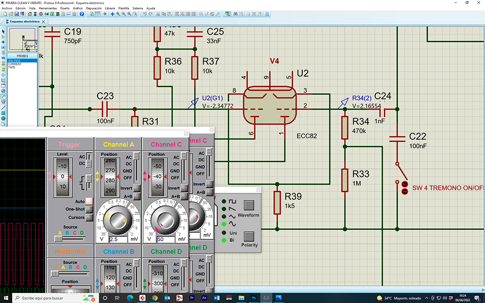

I have simulated the entire amplifier and if I get voltages that oscillate around 2V
« Last Edit: June 08, 2022, 12:26:02 pm by rafaelctt »
  • Posts: 3147
« Reply #49 on: June 08, 2022, 01:12:30 pm »
Are you sure that’s a VDC (average) measurement, eg rather than instantaneous?
One grid looks to be -2V, the other +2V.
