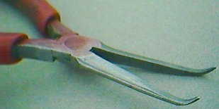

my bench through two of the mounting holes. First take a fine pair of bent needle nose pliers and make a 3/4 loop on the end of the buss wire. These pliers are Snap on model E704ACG and work the best of any tool I have tried. |

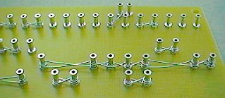

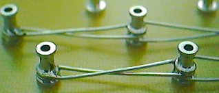

Hook the 3/4 loop you made above around a lug at the end of a buss and then hold the loop tight against the lug with the pliers. Take the buss wire
and pull it back and forth between the lugs that you want to join together. If you have a large gap to span make a 360 degree loop around a lug before you continue on to the next
lug. If you are just joining two lugs that are next to each other, you do not have to make a double 360 degree loop. Continue to lace all lugs together by looking at the layout diagram
to see which lugs get joined. The top photo shows how the buss spans large gaps. Notice the double loops around the lugs. The bottom photo shows two lugs joined side by side. |
