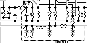

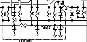

Non reversed layout diagram Layout diagram reversed

The top left diagram shows the bias circuit layout diagram area on the 5F6A board.
The bottom left photo shows the bias circuit on the circuit board.
The top right diagram is the same diagram only a reversed/mirror image.
The bottom right photo is the back side of the bias circuit board.
On the layout diagram there is a squiggly line that says "under Board". This is a wire that connects the bias circuit negative bias voltage to the two 220K power tube input grid resistors. It is connected from the bias pot over to the two 220K resistors. Notice the 220K resistors are joined by a small buss. The is where the bias wire is soldered. The negative bias voltage comes from the bias pot then enters the 220K's. When the board is installed in an amp, the bias voltage will then go to each power tube input grid. (pin#5).
Some circuit boards have just one wire under the board like the 5F6A board in this example. Some circuit boards like the AB763 circuit have several wires under the board. Don't forget to connect the under board wires. Double check yourself to make sure you are connecting them properly. You are working on the back of the board and it is easy to get confused.
