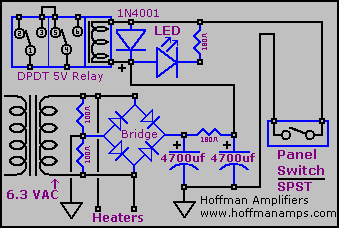

Hello guys. I'm new here, I'm a guy from the Netherlands and I've just 'finished' my first build, a 2204, except for the relay circuit switching.
I'm using Doug's circuit from the relay switching page on this site. This one:
Here is my 2204 build that I built using a chassis and trannies of a 2205. It was wrecked so I took the guts out and made myself a hotrodded 4 gainstager with a (supposedly) toggle and footswitch switchable boost triode V0.
Here is a pic of the amp, it wasn't fully finished here but it serves the purpose.
I just can't get the relay circuit to work. I've tried with the transformer center tap to ground, and the ground of the rectifier bridge to ground as well. Didn't work. Then I disconnected only the transformer CT, also didn't work. Then I put the transformer CT back to ground and disconnected the ground side of the rectifier bridge, also no dice obviously as Im rectifying only half.
Will using an artificial CT with two 100 resistors give me more supply voltage than with a transformer CT?
Also, I have another question regarding this. I was also thinking about elevating my heaters to 50 VDC, by using a voltage divider off B+. If I have my transformer CT disconnected I won't be able to reference it to 50 VDC, or can I? But this would mean that I'm rectifying a lot more voltage at the rectifier. The resistor in Doug's schematic between the two 4700uF caps is a 180 ohms one to lower the supply voltage. Can I put a much higher value resistor there instead to lower the voltage to 5 vDC to power the relay circuit?

You should wire it exactly as shown in Doug's diagram. Leave the heater CT disconnected. You should see about 7VDC across the large caps with the switch open. When you close the switch, the LED should light up. Does this much of the circuit work in your build?
If you want to elevate the heaters, it would be best to add a separate transformer to power the relay so you can keep the switching circuit referenced to ground. I wouldn't worry about that though until I got the relay circuit going first.

No luck so far guys.
I've wired it with an artificial CT, and I measure around 7,6VDC at the output of the rectifier which is good and SHOULD be enough voltage to power the relay and the LED. The relay and the LED don't work yet.
If the switch is turned off I measure the same 7,6 volts across the relay coil. When I turn the switch on I measure 0 VDC. I thought that if I took the relay out of the IC-socket the LED would still be able to power on. It also doesn't.
I've checked all my wiring, and so far I can't really see a thing wrong with it. Can it be that I swapped my relay coil + and - and the diode? Can't my PT supply enough amps? Or what can be wrong? I'm puzzled.

Alright, after going through it several more times and doing measurements everywhere I've managed to fix it.
It's now finally finished and switching works. Turns out I wired the LED the wrong way around, which made me feel stupid. It's a beast now. It has tons of gain and I'm surprised how much it grinds and how tight it is.
