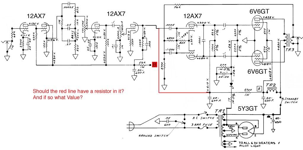

The original posisition was the rear of the chassis.   Now the rear of the chassis is full of other parts.  I have a place to mount by the PT and filter caps.  I moved the caps so they are about 1/2 from where the resistor will be.   If need be I can make some kind of heat shield.
Are we talking 200 degrees or 800?  It makes a big difference when its sits close to 80 year old wood.  Or maybe I can find a place on top of the cab.  Maybe by the power tubes.
I like the amount of voltage your idea gives me.  What would be a more real world solution?

If it were me, I would first trace every wire and component by the schematic, and do that at least twice. Because, I checked and double checked the schematic on my first time build, and it wasn't till the 5th or so time thru that I caught my huge mistake, and it  should have been glaringly obvious (and would have to a normal person  :laugh: )

I can't believe your amp guy didn't take the extra 5 minutes to "know" why he had no reading on the bias tester.
Fender used 470Ω screen resistors on almost all his amps. 6V6s, 6L6s, 5881s, all the same. If you used 470Ω screen resistors , you're fine. Something is still not right. Check voltages on ALL pins on both 6V6s and report your findings.
RE: the experiment with the 7750Ω power resistor.... I never meant to use that resistor as a 'fix' for lowering the B+ in your amp. I just wanted to see how much the B+ would drop when you added the additional load. The voltage dropped to 450V. That's an additional load of 58ma. IMO, 450V is still too hot for 6v6s, but it is very common to see 450V on a pair of 6L6s.
I don't know why you chose to put 6V6s in this amp, but here's my recommendation based on the power resistor experiment. Use a pair of 6L6s. And change the rectifier to a GZ34/5AR4. And get a meter that's capable of accurately reading voltage and resistance. $20 should get a cheap DVM that will get the job done. That Fluke T5-600 is a fine instrument but it's more suited for an auto mechanic or electrician. It just isn't intended for poking around inside an amp.

V2 and V4 are messed up. Divide and conquer. Fix V4 first.

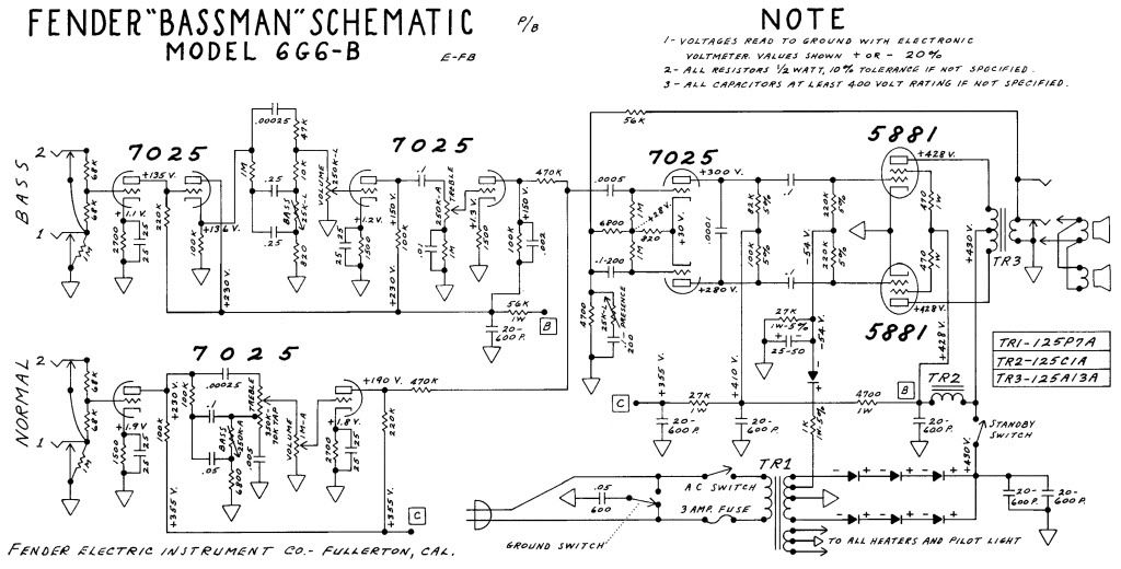

Compare to the voltages on your green schematic. Your Fluke tester will not be able to read the grid voltages on V4 but it should read the cathode voltage OK. Looks like V4 cathodes may not be connected to ground properly. Do a resistance check with amp off--- V4 pins 3/8 to chassis. Should be approx 10K to 12K.

Holy Crap You Just Found Something!
I deleted the presence control from the original Bassman schematic and never put in the ground!  Looks like I need a 4700 resistor to ground.

  I installed the 4.7k resistor to ground from what would have been the presence knob, also the new tubes.  Now I am able to get an improved signal thru it, even though its still terrible.  At this point we are making some good progress.
Also, I may have wires the pots backwards.  Does this matter other than them working backwards?  Looking at a layout of an amp, Does it assume you are looking at the back of the pot, or the side with the stem?

Your new voltage readings look OK except for V3-7. No way can V3-7 be -37v! Check that again.
Doesn't matter. The typical Fender layout is viewed from the back side of the pots.

I suspect that V3-7 does not have a path to ground. It should measure approx 1 meg to ground (with treble pot set to max CCW). But I don't think your tester can measure that much resistance. Use some clips to temporarily connect a 1meg (heck, use anything between 100K and 2meg) directly between V3-7 and chassis. What's the voltage now?

I was comparing my schematic with the original fender schematic and I may have discovered a mistake.
Here is the original schematic:
Here is the schematic that I built:
And here is one showing a change that I may need to make.  I think that by deleting the normal channel, I may have removed a b+ feed into the first power stage cap.  The red shows the modifications from the one I built.
Would this be better?  Maybe even correct?  And does the red line need a resistor in it?  Maybe a 220k.
« Last Edit: October 22, 2011, 10:08:14 am by blown240 »
Offline terminalgs
  • Posts: 700
Re: Amp Build From a Vintage Radio
« Reply #140 on: October 22, 2011, 11:20:23 am »
be sure to connect "B" ("B" inside square,, not B+)  to "B" (the left choke lead),   you originally had that connected to the wrong side of the the 4700 R.
you don't need the red line.   the last 12ax7 stage of preamp  gets its B+ from the "B" rail  (follow the 100k plate resistor),   not the "C" rail.  if you follow the original schematic,  from "C" rail to the plate of that 12ax7 section,   there is about 1.1M of resistance in between.
academically speaking:
if you used that red line, you absolutely do need a resistor in there,  otherwise the 20/600 filter cap at the bottom end of that red line will look like a short to ground for the AC signal voltage.  you'd more or less be giving that 12ax7 section two plate resistors,,   I don't know what you'd end up with really....
also,  12gauge wire is overkill,   especially for anything that doesn't carry any DC current (like volume pot grounds).   Don't feel that if you have a ground problem, 12g is going to fix it. even the 12ax7 cathode grounds have current measured in milliamps.   you can use 22awg, or 26awg..
