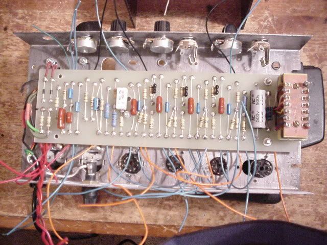

He also omitted the dry/wet mixer, which may be interesting to put back in.
Well, that statement got me wondering, so I decided to play around today. I replaced the output level pot with a 250K mixer pot to be able to blend the wet and dry signals. I was expecting to just hear vibrato with the dry signal mixed in. That ain't what happens though! As you blend them together there is a phase cancellation and reinforcement going on that produces a variety of very good tones. Much more versatile than my original circuit. It's a keeper! Here's my revised schematic...
    http://home.comcast.net/~seluckey/amps/warbler/warbler_rev1.pdf

I don't think you need the tremolo from the Tore-T revibe. The warbler revision 1 gives a very lush sounding tremolo effect as well as the vibrato effect.

I didn't do any of that stuff. I'm sure there are a lot of neat sounds available with all the different pots. Having everything adjustable can also be a nightmare.
EDIT... I just realized that the mix control that I've added (see revised schematic  and comments above) is basically the same as his clean switch and pot.

I've spent a couple hours experimenting this afternoon. Mixing and matching different combinations of stages together. There were some interesting sounds. I'm not sure how useful some would be. In the end, I put mine back to revision 1 level and buttoned it up. The 4 knobs on the warbler will keep you happy for a long time. I'm gonna call mine done.
I've updated the revised pdf to include a drill guide in case you want to build one. If you decide to do a lot of experimenting please keep us advised.

Well got started this morning digging and looking for a chassis to work with. I found this old Wurlitzer organ SS chassis and this is what i got done today. Have to wait on the turrets from Doug to build the board. Cant wait to hear this thing /
« Last Edit: December 30, 2010, 08:31:29 pm by plexi50 »

plexi50,         Man, when you said you could'nt wait to get goin on this build , you were'nt foolin! Looks great already!
What did you use to clean and prepare the chassis before you panited it? Looks very nice. Also what did you finish paint it with? Any/what type of primer? How many coats of each?

Plexi50, just a heads up before you load turrets. You have the transformer mounted on the bottom side of the board in the pics. The transformer is fragile. I'd let that be the last thing to install on the board.
I'm done with mine. I did change the mix pot to a 500K-L to give some more isolation between the dry and wet signals. I can't hear any difference from the original 250K-L though.
Yes good idea. I just wanted to see if all my drilling matched up. Perfect template. Is your transformer flush mounted on your board? There were two nuts on the bottom of transformer mounting screws acting as stand offs. I removed them because the screws were not long enough to go all the way through to the backside of the board. I can see you really need longer screws to have that nut on the bottom to keep the transformer top half from pulling down and possibly breaking it as you tighten the two screws down on the board

Boy this is quiet a job. The hard work is done. I ordered the wrong parts and wound up with eyelets but it worked out very well
All i have left to do is wire up the PS,pots and tube sockets
Oh yeah and the PITA  heater wiring. I hate wiring heaters
The under board wiring sucks the life out of you
« Last Edit: January 04, 2011, 04:20:46 pm by plexi50 »
