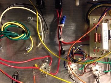

Ed, I did some checking this morning.
1. I don't have any squeals with the cut control at any position, even with both volume controls set to max.
2. I had just the opposite results concerning jumping channels and input jacks. My input jacks had dirty switch contacts. Bet yours do too. I just used some sandpaper and contact cleaner to fix mine. Once the jacks are cleaned and switching properly you will need an open plug (not shorted) inserted in the unused input jack to get any sound when jumping the channels.
Lego, to lower the B+ just insert a 250Ω resistor between V8-3 and the STBY switch. I have an idea that will be easy to implement. It basically replaces the SPST STBY/OP switch with a three position DP switch that would provide STBY/SAG/OPERATE functions. The dropping resistor would mount directly to the switch. Doug has the switch.
BTW, I've updated my web page to include a better gut shot that also shows the Brilliance Switch mod. And the original PDF has been updated to show all the changes we've talked about throughout this thread.

Awesome Ed, I feel better knowing another amp has fired up. I thnk I'll be the only one with the two board version tho. Details on your tweaks for lowering the voltage, it's not that I can't look it up but I'd rather see it from you guys. I should order my cabinet so it's here when I'm done. I think I want a combo now , but how would I do that with the way the chassis is built
With a combo you can mount the amp to the back panel just as you would mount it to the botton of a headbox.  This is one method and works well if your back panel is thick, like 1/2 inch plywood.
Another method, which I prefer is to drill holes at the end of the faceplates and matching holes in the tip of the main cabinet like a tweed and many other amplifiers from the late 50's and earlier.  The huge benefit in this method is when you remove the back panel the entire amp is right there.  Makes it easy to change tubes and check bias and do some repairs.  Some of the newer amps are this way again, but doesn't make them much easier.  Like the Hot Rod Deluxe, bit it is easier to change tubes and set the bias than in a Blackface Deluxe.
If I hang the chassis like I mentioned, i usually use large fender washers and acorn nuts to finish it off.  It will need a vent in the top behind the handle for a heat vent for the tubes.  I put one in my head box and at the rear also.
The only difference in the 2 boards is the filter caps are together.  Gotta remember all those loved Fender amps were done that way and did not hurt the tone of the BlackFace amps.  If anyone has an old BlackFace amp they do not like, PM me and I will take it off your hands. :l2:

Another thing.  I built another rail for the back of the chassis similar to the front.  I really like working with the metal wire over the copper I used to use.  You are correct about the floor noise.  I cannot even hear the amp.

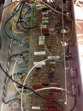

Got a few more leads soldered today, not much tho. I did the rotary switch( thanks for the help Sluckey), one input and the standby here v8-3 to one side of standby, the other side has lead from cap board +one leg of choke. The other leg of choke is B capped to other hot lead from cap board

got the buss up and soldered to pots and the speed switch done.

We need bigger pics.
Offline lego4040
  • Posts: 917
Re: lego's spin on Sluckey's AC15
« Reply #530 on: May 21, 2014, 10:34:26 pm »
Out of respect I am keeping pics small :grin: if someone wants a picture larger I would gladly email. I already see where I'm going to fix some solder joints. Of coarse I pulled out the surf rod for some weekend stripe bass/ blue fish fishing
  • Posts: 5390
« Reply #531 on: May 21, 2014, 11:30:40 pm »
I understand that but you went from one extreme to another.
Offline lego4040
  • Posts: 917
« Reply #532 on: May 22, 2014, 05:25:44 am »
Ok next one will be bigger :icon_biggrin:

Offline lego4040
  • Posts: 917
« Reply #543 on: May 22, 2014, 07:27:09 pm »
trying to keep it neat, I ran the secondary 6.3 to lamp first then to heaters. I had more room on those tabs first

Offline lego4040
  • Posts: 917
« Reply #546 on: May 23, 2014, 04:52:14 pm »
Almost there. I'll post some updated pics later. Have a great Memorial Day Weekend
