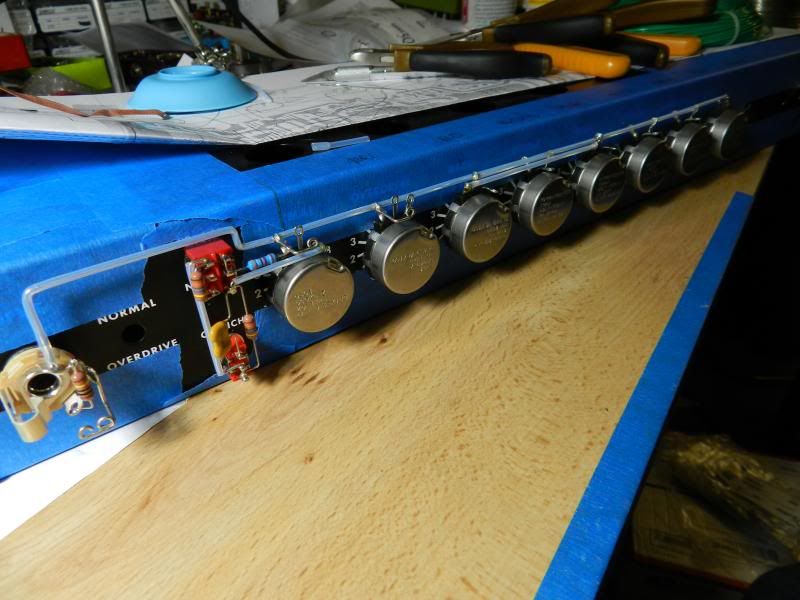

Re: lego's spin on Sluckey's AC15
« Reply #128 on: April 07, 2014, 07:30:10 pm »
Just checked out the build pics and my first thought was "what's with all the spaghetti tubing!? And for grounds too? Leather wrapping of filter caps? This has OCD written all over it and heaven help if there's circuit modifications to be had? Other than this, it VERY nice indeed and I look the other way on that other stuff.  :wink: Good job lego!  :icon_biggrin:
  • Posts: 5227
« Reply #129 on: April 07, 2014, 08:30:36 pm »
A little chassis work today. Tube sockets, cap can, and board mounted. Looks like the sun is coming out though...
EDIT... big pic removed.
« Last Edit: April 16, 2014, 07:20:37 pm by sluckey »

« Reply #130 on: April 07, 2014, 08:54:13 pm »
 :huh: How did you get that far so fast. You keep blank chassis laying around .
« Reply #132 on: April 08, 2014, 05:36:06 am »
Jojo, what do you mean by Spagetti tubing?  Looks like the Marshall style layout Voa AC15 is the amp to build right now.  Lego was building and posting at BYOC and Sluckey invited him over here.  Well a few of us begged, like me.  I have 2 great builders ahead of me cutting a path and testing the waters.  My build should go fine as a result.
I had a 63 Vox AC15 Single 12 years ago.  Before I understood Push Pull and could only really repair TV and some radios.  I was around 16 and could not afford a amp that was nor reliable.  Back then we played so loud I cranked and pushed it hard next to my Super Reverb.  Lons story short, I sold it for next to nothing, but learned a valuable lesson.  Rare amps become more valuable.
I want another as it was the coolest amp I ever owned.  Euphoric recall. :l2:
I have done research, lots of it.  I am interested to find out how the Hammond OT is going to work.  I have a way to get an original and I found an original choke.  The guy with the original suggested I use a Mercury 2 tap 59 series clone of the radiospares for durability if I were going to play it often.  Anyway, I mentioned to Sluckey about putting the filter caps on the board, so he graciously revised the file for this.
He is building this version and Lego is building the short version with the cap board.  I don't know if either will make a difference, but I am leaning hard towards the Long version.  I was waiting for Sluckey to revise the layout and I started with building cabinets.  He did it much faster than I thought.
I think he is really jonesing for one of these himself.  Just to bring you up to speed since you were on holiday in Hawaii.  That is what the upper class does. :icon_biggrin:
« Reply #133 on: April 08, 2014, 05:39:27 am »
I am missing the 8 pin socket for the optional 5v Rectifier.  Did you ditch the idea, or is it coming.  I was planning to do this too, but I wanted to see if you were going to make it switchable and how you were going to do it.
t first glance it looks like a chassis for a huge preamp.  I had to count the sockets. :laugh:
You have the cap centered on 4" and the sockets continuing centered on 2" leaving 2 " at the end"?
« Last Edit: April 08, 2014, 05:59:59 am by Ed_Chambley »
  • Posts: 5227
« Reply #134 on: April 08, 2014, 06:09:22 am »
I was forced to use the EZ81 rectifier because I can't find my big step bit. I remember doing something very clever with it, but I don't recall what that was! If I find it before I start wiring I'll probably enlarge the hole and use a 5Y3. I was never planning on a switchable rectifier.
Those gold plated Cinch sockets look good on that blue painters tape, don't they.    :grin:
In the image below, the clear/whitish insulation on the buss wires and connection is called "spaghetti" tubing.
In reality, the stuff that guy was using is teflon tubing that he's sliding over exposed buss wire to prevent an accidental short-circuit. There was a varnish black cloth tubing used in the old days called "spaghetti". Antique Electronic Supply has some that's white. I originally saw it inside of a kit-build Fisher hi-fi, which still had the assembly instructions where the loose insulation was called spaghetti.
« Last Edit: April 08, 2014, 06:30:06 am by HotBluePlates »
They sure do, you are not planning paint I hope?  Are you planning a cabinet and faceplate for this or you going for the industrial look again?
I have found some really nice old ceramic sockets, but I only have 6 of them in 9 pin.  They look so nice, I am going to mismatch, I like them so much.
Yes, I have some of that.  Just did not know what it was called.  I did not notice any on Lego's board.  Thanks, I wao=ndered what it was called.  I have been using it a lot lately attempting to build without any wire or tagstrips.  True point tp point.  I started with a champ and then a 5E3.  Took that apart and now I am truing to do a 5G9.  Takes a lot of thinking and I am really getting a great appreciation for the guys that built all these old Console Radios that ate quiet as all gitout, but they used parts they had that we will not use because they are too noisy.
Thanks for getting me up to speed ED! I have an AC15 w/ Celestion Blue and a homebrew EF86 AC15-ish in a chassis-only...one of my earliest builds but not sure if these are a lot different or "special"? If so can you enlighten me on it? Is this also related to BNWitt's desired build from a ways back at all?
