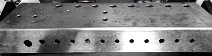

It appearss you have 3 additional drill holes and I believe I will have one.
Ha. I was wondering if anyone would notice that. I had the board drilled and was in the process of loading turrets when my Xicons arrived. When I saw how small the Xicon 0.1s were, I made a hasty mod to my board to better accommodate some of those tiny caps. That left me with a few extra holes on the edge near the pots.
How far from the chassis edge did you guys center your 9 pin sockets?
1.25"
Any specific reason to have the Leads from the Output Transformer short?
No. Just keep them away from the preamp circuit.
Any reason not to put the cap can inside?
Not if you have room. Saves making a big hole.
Sluckey, any specific reason for the DPST power switches?
I only had two Carling SPST short bat switches. Those DPDT switches in the power section look like the Carlings from the outside. They actually simplify wiring the line side of the PT. If I had four SPST Carlings I would have used them.

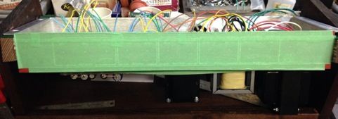

I got around to cutting face plate and taping it on to chassis. I center punched the plate holes and will drill out. My back ordered pot should be here this week as well as my smaller stand offs and Cap can cover. I'll strip it down,deburr yadda yadda yadda and start assembling. My buddy who just bought a pos twin wants to buy this amp now  :l2:

Ed, on the 9 pin spacing I kinda eyeballed it and made sure I had enough room on both sides. That Grey Mercury looks sweet, I looked at the Mercurys for this build but to $$$.

Ed, I'm concerned about the location of your OT. It's right on top of the input jacks! That's courting with danger. The highest signal level in the amp is only an inch away from the lowest level signal in the amp.
If it were mine, I'd shift the choke and OT closer to the PT. Many successful amps (Plexi for example) have the OT mounted very close to the PT. I can't find any examples where the OT leads are close to the input jacks.
Re: lego's spin on Sluckey's AC15
« Reply #395 on: May 11, 2014, 07:24:45 am »
Well, it is certainly no problem to move it at this point.  I did not consider that, but the photo shows it clearly.  Marshall designs do not have the input jacks so close to the center.
Great catch as I was thinking about other things and the last thing on my mind was the location on the inputs.  My mind naturally considered them all the way to the right.  I will get me a little plug.  I will make it not noticeable as this is the nicest work I have ever done.
You think if I move it another 2 to 2.5 inches it will be good?  Is the wires or the transformer itself?  If the wires are the problem, I could use some mini conduit I use when I have 2 chassis and bring the OT wire into the chassis in an ideal location.
I am looking at a amp book I have and I cannot find an example done this way, but I cannot really find a layout like this one.
I just checked and I have a build where the OT is actually next to the PT with the choke last.  I do have a shield between them, but I removed it and noticed no differences in voltages or sound.

Ed, this is how I was gonna do my iron...
But remember, I scrounged from my old Lightning. I would have had to splice too many leads so I finally just decided to keep the three pieces in the same layout as the Lightning.
Putting the OT right next to the PT has been successful with a lot of amps, including high end hifi stuff, such as this Dynaco Mark III...
Will your choke fit inside the chassis? If so, I would consider mounting it on the end right next to your dual can cap. Then rotate the OT 90° and about an inch away from the PT. Otherwise just mount like the Marshall clone shown above.
