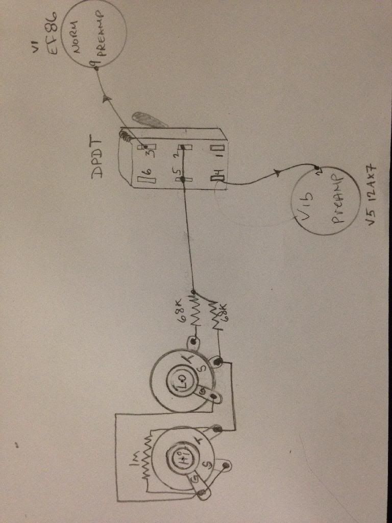

Don't understand.  Standby=No Dc, Correct.  Marshall switches go down for contact and up to break contact.  I like the term operate, so shouldn't operate be on the bottom replacing ON?
Also, if you would, please address the jumping.  If I can put a switch I would love to remove the low jacks.
The switch don't care. If you want to play guitar when the switch is up, put "OPERATE" above the switch. If you want to play guitar when the switch is down, put "OPERATE" below the switch and simply rotate the switch body 180°. In my mind it makes more sense to flip both switches up to be on and operating.
You can use a switch to jump the channels. Here's another option... Just use a single input jack and a three position switch to select either channel or both channels. Might look like this...
EDIT... big pic removed.

I really want to do the front switching and I know you know how or you would have not mentioned it.  I just cannot get my head around it.  Is it on-on-on DPDT with the input to the center.
Yes. It's a DPDT on-on-on. Connect the jack to both center terminals. Connect one end terminal to NOR tube. Connect the opposite end terminal for the adjacent switch to the VIB tube. It may be difficult to find a toggle switch that matches your Carling switches though.

I get on-on-on but why dpdt not spdt
I've never seen a single pole three position switch where the center position made contact with both outer lugs (ON-ON-ON). The usual configuration is the center position makes contact with no other lugs (ON-OFF-ON). I suppose someone may make such a switch.
However, ON-ON-ON configuration is commonly available in double pole switches. Look at switch 7211 in this C&K spec sheet (page 2). Imagine pins 2 and 5 tied together and connected to the input jack. Now connect pin 3 to CH 1 and pin 4 to CH 2. This wiring will give you CH1, both, CH2.
     http://www.mouser.com/ds/2/60/7000Toggle_20feb14-241455.pdf
My other question is since it's only one input each channel are you using high or low?
It's high. The low input is just a voltage divider sample (lower level) of the high input.
You get single-pole On-On-On in a rotary switch. It takes 4 contacts; 3 switched circuits and a common.
Like you said, maybe someone out there makes one, but I've not seen it in a toggle switch. You'd probably only need to buy a couple hundred-thousand to have a company custom-make them.  :icon_biggrin:

That bias mod is easy enough to do. I drew your switch out and I get it, I had my number to pins wrong when I first drew it out. But with the two lows gone now and only one line going into switch legs 2&5 what is the wiring layout for the two jacks. I know you need the 68k for them but not sure on the rest

I'm going to try and answer my question  :l2:  does this look right? Or do I loose that 1M or am I way off
  • Posts: 5390
Re: lego's spin on Sluckey's AC15
« Reply #180 on: April 10, 2014, 04:57:24 pm »
yes

There is one thing I forgot to mention... You need to remove the 1MΩ from the hi jack. Now install two 1MΩ resistors on the switch. One connects to pin 3 and gnd, the other connects to pin 4 and gnd. This way both tubes always have a grid return to ground regardless of the switch position.
