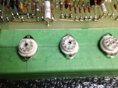

I did some mocking up and this is what I got so farso I started with board placement, then sockets which start 1.5" of edge then every 2". From faceplate to board will give me approx. 1.5".  As for tranny I'll keep them like Sluckey's. Suggestions welcome. Oh I can either put cap board inside right next to main turret or dog house it?

Re: lego's spin on Sluckey's AC15
« Reply #335 on: April 25, 2014, 02:08:14 am »
Come on now, even when your just testing the lay out, use the rubber grommets, so you don't scrape the PT's or any other wires insolation.
Other wise, looks real good to me!
                     Brad      :icon_biggrin:
« Reply #336 on: April 25, 2014, 03:10:56 am »
Looking good.  Those 9 pin sockets look real nice all in a row there.  Where did you buy those?  I will run our of all my nice ones on this build and will need to order some.  You guys seem to leave the tape on there longer than me.  Do you take the parts back off to remove the tape, or will it slide from under the edge of the parts?
« Reply #346 on: April 27, 2014, 01:11:50 pm »
Here are a couple of photos of my board.  I will have cab photos next week.  I used larger caps than I planned to use up some I have had around.  Let me know what you think and who wants to be the first to mod this board?
You may notice I have no ground wires yet.  I am planning to build the ground scheme inside the chassis.  The ground layout is really nice..  The photo of the iron shows how short my leads are on the Power Tranny.  I believe I will be making a single row turret strip to connect.  I have found some lead I cut on a previous build and it matches.  I could simply add it.
Now its time to layout the chassis for punching and drilling.
« Last Edit: April 27, 2014, 01:23:42 pm by Ed_Chambley »

« Reply #347 on: April 27, 2014, 01:23:31 pm »
Hey, that looks familiar!
« Reply #348 on: April 27, 2014, 01:29:35 pm »
Yes sir!  Layout done by one of the best and one I consider a friend.  I am just an old hack and am painting by numbers.
The caps fit better than I thought once I was working on it.  I am saving the chicklets for my next build and plan to do a Hoffman style board and they will come in handy.  I will finish this one first.
 I hope you caught up on your chores you neglected while building another silly amp.  Are you ever going to grow up? :l2:
