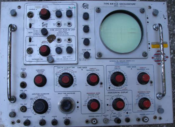

Yeah, similar happened to me. I bought one of those early Tektronix 555 2-man scope power supplies at the last CHRS flea market for $5. One of these:
http://www.lemis.com/grog/Albums/Tektronix-555.php  very bottom of page.
It looked like it was in decent shape. When I got it home, I could see some of the tubes were cracked. The 6080's? Nope. The 6AU6's? Nope. 3 out of 3 12AX7s were cracked and 2 were 5751! Argggggh.

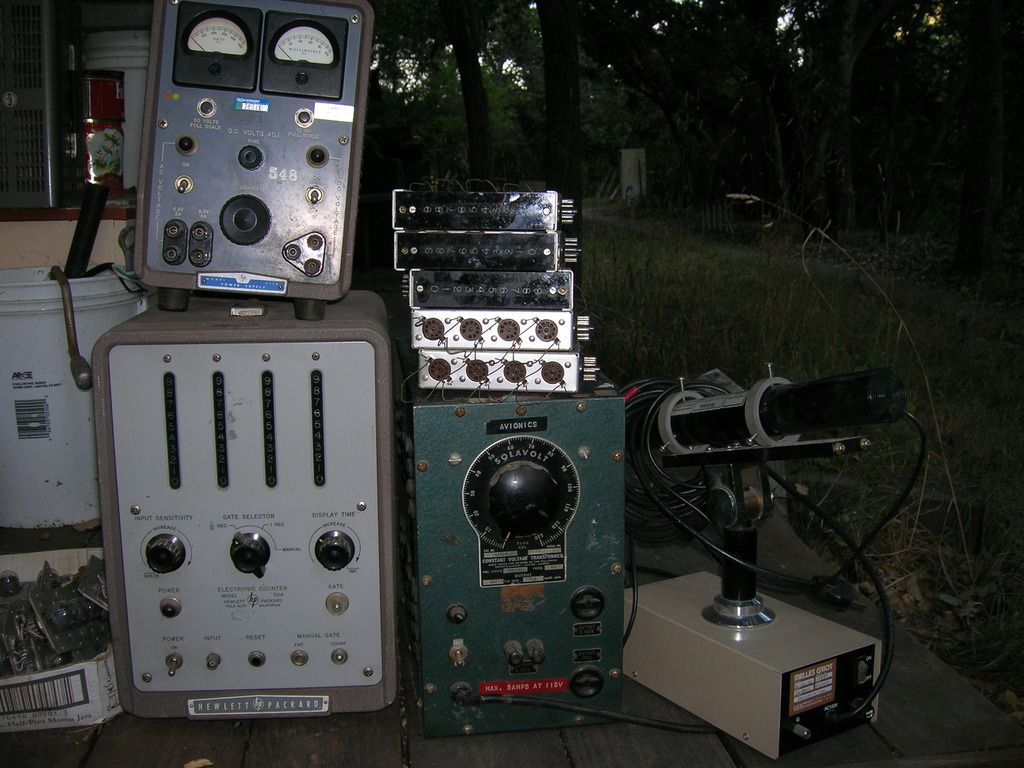

One of my best scores evah!! Fun.
hp 711A Power supply. I have wanted this particular model for a long time because it is small and will fit under the bridge on my bench. 500 v, 100 mils. Kewl. $5. Oh yeah, has 2 qty GE 6L6GC as pass elements. Very excited.
hp 521 counter. I know it may sound weird but I have wanted a counter like this (using the 4-12AU7 decade counters....either Beckman or Berkeley Scientific) ever since I used to wander onto Canal St in Lower Manhattan and find the internal decade boxes. That would be like almost 50 years. This was among the very first electronic counters that were available. With 7 extra decade boxes....and now....guess where all my Conn organ 12AU7s can go? Each decade uses 4 of them! $10.
Solavolt variac and constant voltage transformer. 50 lbs, in its own box.  $15.
The other thing is A LASER!!! Free.
All this for $30. I am supposed to resist this incredible pile of crap??? No way.
