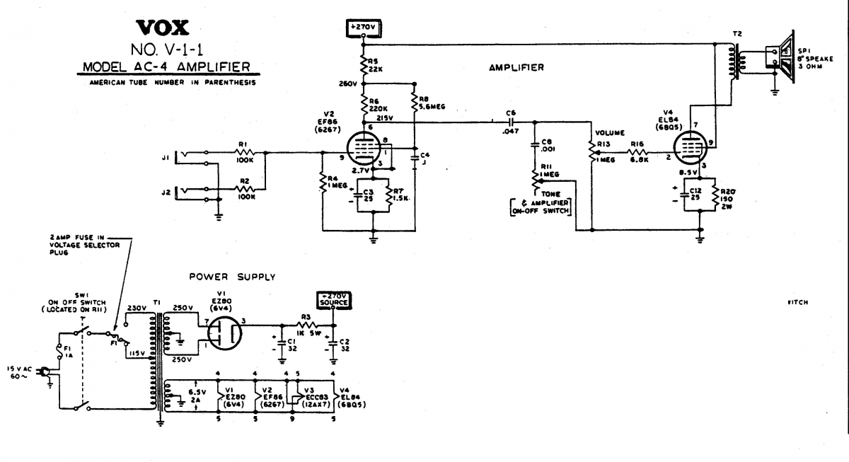

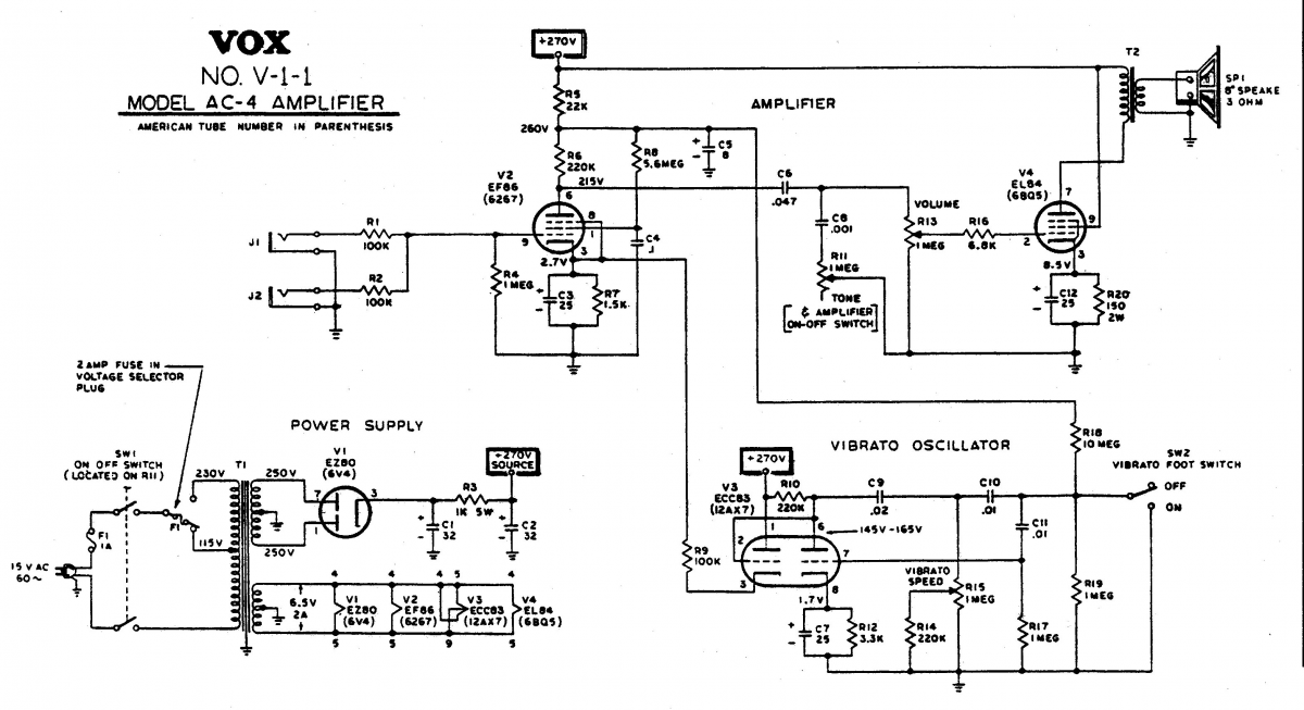

The reference schematic used for this build is this
and it is derived from this
he original PS shown uses two capacitors (32uF) + one resistor (1K - 5W)
there is only one node that is connected to the circuit, as you can see, B+ is derived from the +270V point and feeds the whole circuit, the two 12AX7 tubes and the EL84 tube
no distinction on B+ node on this version of the AC4 schematic, for the preamp tube and the power tube only one source

Re: Vox AC4 Question(s)
« Reply #117 on: May 23, 2020, 04:28:45 pm »
So why is an important filter cap left out of the derived circuit??
« Reply #119 on: May 23, 2020, 05:02:33 pm »
 :laugh: :laugh:
Seems that the PS is to be updated
Someone gived the advice but seems that no one payed attention (or, at least I didn't  :icon_biggrin: )
Secondly, your schematic appears to lack filtering. In my archives, the original schematic shows two 33uF then a 8(10) uF capacitor and the EF86 is NOT connected to the B+, but to some C+ sharing the HT node of the third cap.
« Last Edit: May 23, 2020, 05:07:45 pm by kagliostro »
« Reply #120 on: May 23, 2020, 06:02:44 pm »
Wow...
So here is the "original" schematic. The only difference is the 47u and 22u instead of two 32u filter caps.
Offline dwinstonwood
  • Posts: 1218
« Reply #121 on: May 23, 2020, 06:15:59 pm »
This also gives me voltages in LTSpice similar to those shown on the original schematic: 264V B+ and 205V plate. The schematic shows 270V B+ and 215v plate. This slight difference is probably due to my EZ81 model, etc.
  • Posts: 11600
« Reply #122 on: May 23, 2020, 06:59:05 pm »
I just caught up n see I'm 2 blame  :think1:
when I cut up the schematic in post 2, I took too much tremolo out  :BangHead:
watch the watchers  :icon_biggrin:
Offline 66Strat
  • Posts: 604
« Reply #123 on: May 23, 2020, 07:35:11 pm »
I chalk it up to target fixation.
I was focused on the two 32uF capacitors in the power supply and missed the 8uF cap.
Regards,
JT
