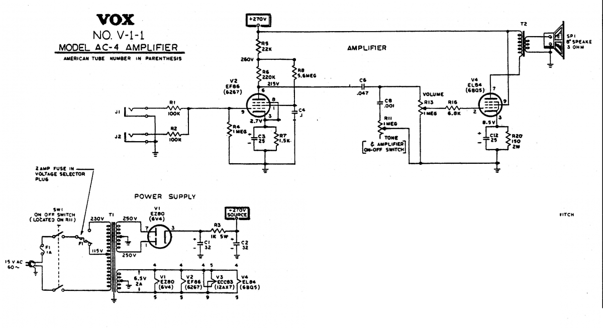

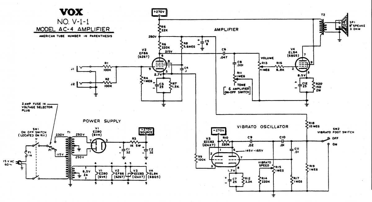

The reference schematic used for this build is this
and it is derived from this
he original PS shown uses two capacitors (32uF) + one resistor (1K - 5W)
there is only one node that is connected to the circuit, as you can see, B+ is derived from the +270V point and feeds the whole circuit, the two 12AX7 tubes and the EL84 tube
no distinction on B+ node on this version of the AC4 schematic, for the preamp tube and the power tube only one source
The use of an added e-capacitor (with resistor to form an add on filter node) is often seen in amps like champ 5F1 that has the tendency to humm a bit more than what we would like
The use of a separated ground at the input jack is "good practice" applied in many amps; I told to use it and if on trouble, the preamp ground can easily be connect to the power tube amp ground (at the CT Bolt on chassis), to verify if this give on this circuit/layout a better performance
I didn't told the value of resistor/resistors on PS must be increased, I told maybe, NOT it must (read what I've write on previously post), according to voltages within + or - 10-20% on the circuit (that are fine); of course, the closer to what is write on the schematic, the better

Re: Vox AC4 Question(s)
« Reply #117 on: May 23, 2020, 04:28:45 pm »
So why is an important filter cap left out of the derived circuit??
 :laugh: :laugh:
Seems that the PS is to be updated
Someone gived the advice but seems that no one payed attention (or, at least I didn't  :icon_biggrin: )
Secondly, your schematic appears to lack filtering. In my archives, the original schematic shows two 33uF then a 8(10) uF capacitor and the EF86 is NOT connected to the B+, but to some C+ sharing the HT node of the third cap.

So here is the "original" schematic. The only difference is the 47u and 22u instead of two 32u filter caps.
Offline dwinstonwood
  • Posts: 1218
« Reply #121 on: May 23, 2020, 06:15:59 pm »
This also gives me voltages in LTSpice similar to those shown on the original schematic: 264V B+ and 205V plate. The schematic shows 270V B+ and 215v plate. This slight difference is probably due to my EZ81 model, etc.
  • Posts: 11470
« Reply #122 on: May 23, 2020, 06:59:05 pm »
I just caught up n see I'm 2 blame  :think1:
when I cut up the schematic in post 2, I took too much tremolo out  :BangHead:
watch the watchers  :icon_biggrin:
Offline 66Strat
  • Posts: 603
« Reply #123 on: May 23, 2020, 07:35:11 pm »
I chalk it up to target fixation.
I was focused on the two 32uF capacitors in the power supply and missed the 8uF cap.
