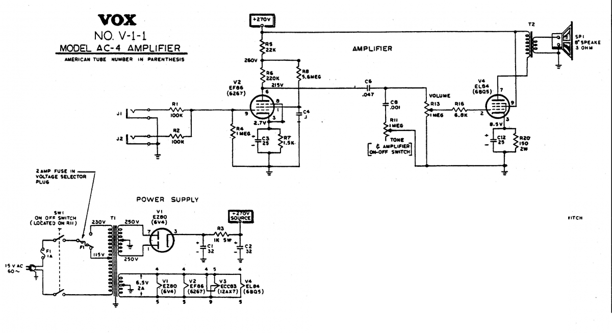

To be safe, why not move the 1K dropping resistor over between the 47Uf capacitor and the first 22Uf capacitor? The difference in overall filtration would be negligible and would satisfy the rectifier maximum capacitance restraint.

Some suggestions:
  • Swap the positions of the 47Uf capacitor and the first 22Uf capacitor. Connect pin 3 of the EZ81 to the 47Uf capacitor. Connect the 47Uf capacitor to the 22Uf capacitor to the left with a 1K ohm resistor. This is the B+ supply for the EL84.
  • A 10K to 22K ohm resistor connects the 47UF capacitor to the 22 UF capacitor to the right. This becomes the EF86 B+ feed.
  • Split the filter grounds so that the filtration for the EL84 is grounded near the power transformer and filtration for the EF86 is located near the input.
  • Connect pin 7 of the EF86 to pin 2 and connect pin 2 directly to ground. I showed this as connecting to the input ground, but it could/(should?) have its own ground.
See attached.

About the added cap and the resistor
Post #82
if you connect the e-cap that feeds the preamp to the first cap node instead to the second node you lost smoothing effect
BTW  the original AC4 uses 2 x 32uF capacitors on the PS, why you lowered the value to 22uF ?
OK you added a 47uF but your interest is to increase the filtering to avoid humm, don't you think it will be better to add capacity without decrease it in the further node ?

The rationale is to provide two separate B+ nodes, one for the EL84, and one for the EF86. The EF86 draws about 1/10th the current of the EL84. This allows the use of a larger dropping resistor to better separate the B+ nodes.
Post #82
I was rearranging the components that dwinstonwood selected. The 47uF filter capacitor at the input from the EZ81 provides the initial filtration for both EL84 and the EF86. I believe that the ripple at this point can be calculated as Vpp=I/(2 x C x F), (that's if I got the right formula).:laugh: I at this point is the combined current of both the EL84 and the EF86.
Both B+ nodes for the EL84 and the EF86 are filtered further by the 22 uF capacitors at each of these nodes.
See attached.

« Reply #110 on: May 23, 2020, 01:11:16 am »
OK, this arrangement will bw similar to the VOX AC30 PS (each node is feed directly from the rectifier)
But this way you have less ripple smoothing (you don't benefit from previous filters like in many other amp PS arrangement)
To me the correct way to arrange your PS will be this
(EF86 filter ground can be connected to the ground of the input jack, remember this must be a not isolated one, it will be easy to verify if this is the better way or if your way will be better connecting it to the PT CT Ground Bolt with the other filter)
p.s.: Maybe (as you have a missing 12AX7 tube in the circuit and so a bit less consumption, you have to increase a bit the value of  1K resistor on the PS, or maybe both resistors of the PS has to be increased a bit; when you finished the amp verify that voltages are within + or - 10-20% of the project - schematic say 270V at EF86 node)

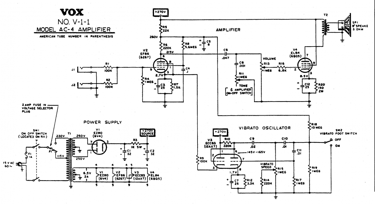

The reference schematic used for this build is this
and it is derived from this
he original PS shown uses two capacitors (32uF) + one resistor (1K - 5W)
there is only one node that is connected to the circuit, as you can see, B+ is derived from the +270V point and feeds the whole circuit, the two 12AX7 tubes and the EL84 tube
no distinction on B+ node on this version of the AC4 schematic, for the preamp tube and the power tube only one source
The use of an added e-capacitor (with resistor to form an add on filter node) is often seen in amps like champ 5F1 that has the tendency to humm a bit more than what we would like
The use of a separated ground at the input jack is "good practice" applied in many amps; I told to use it and if on trouble, the preamp ground can easily be connect to the power tube amp ground (at the CT Bolt on chassis), to verify if this give on this circuit/layout a better performance
I didn't told the value of resistor/resistors on PS must be increased, I told maybe, NOT it must (read what I've write on previously post), according to voltages within + or - 10-20% on the circuit (that are fine); of course, the closer to what is write on the schematic, the better

Re: Vox AC4 Question(s)
« Reply #117 on: May 23, 2020, 04:28:45 pm »
So why is an important filter cap left out of the derived circuit??
 :laugh: :laugh:
Seems that the PS is to be updated
Someone gived the advice but seems that no one payed attention (or, at least I didn't  :icon_biggrin: )
Secondly, your schematic appears to lack filtering. In my archives, the original schematic shows two 33uF then a 8(10) uF capacitor and the EF86 is NOT connected to the B+, but to some C+ sharing the HT node of the third cap.

So here is the "original" schematic. The only difference is the 47u and 22u instead of two 32u filter caps.
Offline dwinstonwood
  • Posts: 1218
« Reply #121 on: May 23, 2020, 06:15:59 pm »
This also gives me voltages in LTSpice similar to those shown on the original schematic: 264V B+ and 205V plate. The schematic shows 270V B+ and 215v plate. This slight difference is probably due to my EZ81 model, etc.
  • Posts: 11536
« Reply #122 on: May 23, 2020, 06:59:05 pm »
I just caught up n see I'm 2 blame  :think1:
when I cut up the schematic in post 2, I took too much tremolo out  :BangHead:
watch the watchers  :icon_biggrin:

What's confusing me is the original schematic that "seems" to have the resistors the other way around. :w2:
