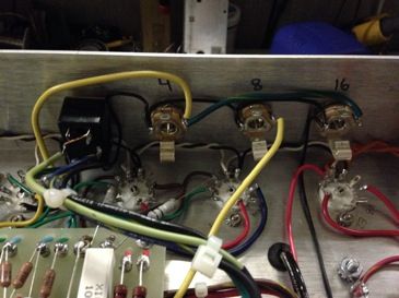

So I want to hook up the speaker jacks, Im using Hoffmans 3 way rotary switch and the new Hammond 1650F. I want to be able to use all 3 ohms availble with the switch but I dont think I can?
  • Posts: 5390
Re: lego's spin on Sluckey's AC15
« Reply #552 on: May 27, 2014, 03:12:47 pm »
Correct. You can't use that switch with that OT. To use Doug's switch you would need the new 1650FA 'easy wire secondary' OT.
I used two jacks and wired the OT for 4/8Ω. I can't do 16Ω without restrapping the OT. Sucks, don't it?

 :cussing: I wonder if using a DPDT switch you can go between 4&16 ohm? I stare at these lines to long my eyes get buggy and I get a headache. I'm all wired up now except speaker jacks

Wire it like I did and deal with it later if you feel the need. You need to get that amp fired up and start gettin' some satisfaction!  :wink:

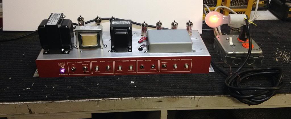

Tomorrow I'll fire it up :icon_biggrin:of coarse on the current limiter first
Here's a possible solution using a DPDT toggle switch. The pic shows using 3 jacks for more versatility but if you only want to switch between 4 and 16, just eliminate the 8 and 16 jacks.

Amp is up and running, I did the poor mans variac and it's good. I'm taking some measurements now. 275vac on secondary and 335ish on rectifier pin 3

 :worthy1: Hats off to Sluckey, I only played amp thru a 8" old speaker mounted in a cardboard box(bench test speaker) and this amp blew me away. At first I couldn't get vib to work and then remembered Eds dilemma. I stuck a jack in it and shorted the tip n sleeve and was in a time warp. Dual board version is verified baby. I took measurements were they were noted in Sluckey's schematic. I will post my measurements

Outstanding! That really looks professional lego. We want to see some gut shots too. Bet your friends over on BYOC would like to know what you've been up to.

Sluckey I made that speaker out to your design I got I shorten the yellow wire tomorrow. I took a break and built another CBGand go plugging for stripe bass and blues
  • Posts: 5390
« Reply #586 on: June 02, 2014, 06:00:05 pm »
I'm thinking strongly about doing that too. It always bugged me to have a 16Ω tap that was not easily usable. There have been so many little mods that keep popping up with this amp that I may put together a pdf just to keep track of it all. If I do I'll let you know.

Sluckey I redid the speaker outs, L>R is switch,4,8,16 ohms. I pulled out rotary switch, tested and all worked. I put it back and had issues. I pulled it out and and bypassed it for know. It plays so sweet I'm just gonna go back to original switch wit 220pf. Here is the back
  • Posts: 5390
« Reply #591 on: June 03, 2014, 05:25:09 pm »
I sure do like the looks of that dog house. Just looks like it belongs. Every time I see your amp I feel like I should do one more, but stuff it in a 17" box.  Still wanting to do the speaker jacks like that too. I know I'll probably never use a 16Ω tap, but it just bugs me having one that's not available.
Don't give up on the tone switch. It's got to be something simple.
BTW, I'm really liking the sound of this amp through the 8" Vox speaker in my 'stuffed vox' project. Makes me really want that Avatar Celestion Blue cab.

« Reply #599 on: June 04, 2014, 06:10:24 pm »
I lied, I had to get the plug done, it was irking me. I didn't wire it in but it's in
